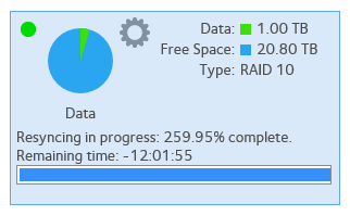

In my quest to find half usable iSCSI performance on the 3220 (https://community.netgear.com/t5/ReadyNAS-in-Business/RN3220-RN4200-Crippling-iSCSI-Write-Performance/m-p/1289066), I upgraded to FW 6.8.0, blew away the array and rebuilt it - into a RAID 10 this time - and left it re-synching overnight. I came back this morning and this is what the re-sync operation was reporting: If you jump in and out of the tab, the % and timer are still ticking. So it looks like a bug. I assume the UI update algorithm was never correctly informed that the operation was complete and the counters continued ticking.3.1KViews0likes6Comments
