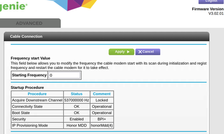

I bought this modem a few years ago and it's been rock solid until the past week. I started noticing waiting icons as the internet seemed to have issues. In the early morning hours I get notices that it's offline. After a power cycle it comes back fine for a while. Mostly, it's been dropping for a few minutes and comes back. The early morning drops are a new phenomenon. For Comcast, I've checked and my firmware seems to be current as v10.11.02. My hardware version is 1.01. I have no issues with cable tv which makes me think it's not a Comcast issue. But could my data signal be a new issue? I don't know enough to speak intelligently with Comcast about it. I'm pasting the most recent log. I'm also attaching a pdf of my modem status. Sun Nov 30 15:38:27 2025 Critical (3) No Ranging Response received - T3 time-out; CM-MAC=9c:c9:eb:3f:a4:d8;CMTS-MAC=00:90:f0:4d:00:00; CM-QOS=1.1; CM-VER=3.1; Sun Nov 30 15:37:58 2025 Warning (5) TCS Partial Service; CM-MAC=9c:c9:eb:3f:a4:d8; CMTS-MAC=00:90:f0:4d:00:00; CM-QOS=1.1;CM-VER=3.1; Sun Nov 30 15:37:58 2025 Critical (3) UCD invalid or channel unusable;CM-MAC=9c:c9:eb:3f:a4:d8;CMTS-MAC=00:90:f0:4d:00:00;CM-QOS=1.1;CM-VER=3.1;204Views0likes5CommentsCM1200 suddenly dropping on Comcast
I am suddenly having the same issue. Have to turn the modem off, wait a minute then turn back on. It's good for a bit, then it happens again. Times are totally random that it goes down. All lights showing its working fine. Router (ASUS RT-AX86U Pro (AX5700) shows all is fine. Attaching logs... Any help would be much appreciated.308Views0likes13CommentsUncorrectable Errors - Tech Questions
