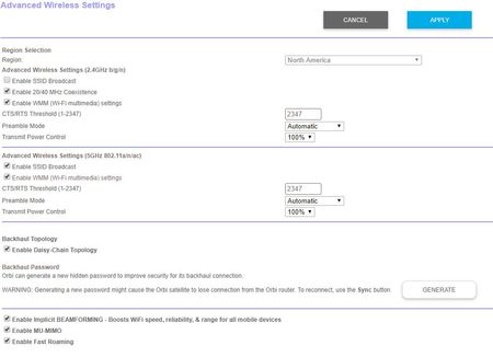

Good afternoon! For those having problems with Android/5 GHz devices dropping the wifi and picking it back up immediately, I have found a temporary solution. The problem with the LG G5 and Pixel was that it was switching between 2.4 and 5 GHz connections regularly. On the Orbi, you cannot separate the SSID's for each frequency so I just disabled the SSID on the 2.4 GHz network. I then chose "forget network" and reconnect my 5 GHz capable devices to the only SSID showing which was 5 GHz. All devices connected to 2.4 GHz stayed connected and the loss of signal quit happening. I suspect that the 2.4 seemed to be slightly stronger between walls so the strongest signal would vary between 2.4 and 5 GHz. Here is my configuration below. So far it has been up and running with no dropping or Orbi restarts for 18 hours. Firmware: 2.1.2 10 BetaWifi regularly disconnecting all devices Nighthawk AC1900 (R6900) - dropping both bands every day
