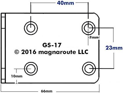

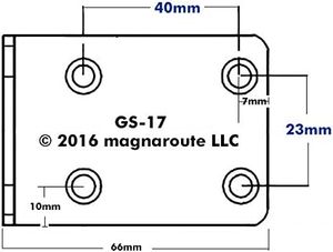

Does anyone know the Netgear PN for the M7100-24X (XSM7224) Rack Mount Kit and where I may be able to purchase 2 or 3 kits from? Netgear doesn't appear to sell these. So far my Google search has only turned up one that is compatible but which is also unfortunately no longer available purchase anywhere (Magnaroute GS-17 Rack Mount Kit Compatible with NETGEAR GS748TPS, XSM7224, and XSM7224S switches).838Views0likes2CommentsChanging Management VLAN on GS724TPv.2 and accessing it from local computer on LAN
