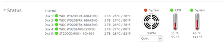

Hi, I just updated my ReadyNas Ultra 6 from OS4 to OS6 -6.9.4 to be precise. Pretty much everything is working aside from the fans who are showing as 0 RPM in the manager while they're running full speed IRL. Is there a way to get some auto control nback or am I stuck with that ? Thanks a lot for any help.4.7KViews1like19Comments
