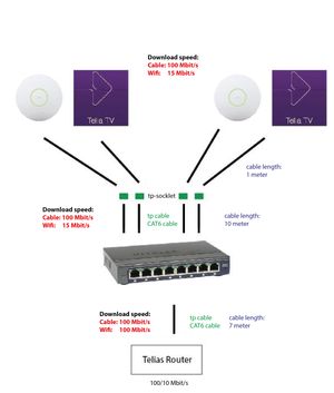

I get a very weak download speed on wifi after I plugged in my Netgear GS108E switch. I have a 100/10 (down/up) Mbit/s fiber connection. Have tried a lot of things but nothing seems to help the speed. What have I missed? Router gives me full speed with cable and wifi. Switch gives me full speed with cable but not wifi (only 15 % of my speed). Access Point gives me full wifi speed (100 Mbit/s) when connected to router. Equipment: 1 Thomson router 1 Netgear GS108E switch 2 Ubiquiti UniFi Long Range Access Point My setup ist kind of easy, Router -> Switch -> UniFi Long Range Access Point (see image below). Thanks4.3KViews0likes4Comments
