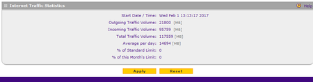

Pictures speak a thousand words. This was open in a tab on an SRX5308 running FW 4.3.4-2, the Tab was refreshed periodically for a while. The traffic made sense, and kept growing over time within expected amounts. At one point coming back from being logged out due to inactivity (but not for the first time), this is the same screen (yes, on the same router) after logging back in: OK... We transfer way more data then that per day. The reset time hasn't changed, it has not been reset or otherwise fiddled with! So if in doubt, reboot. Guess what the screen looks like now: Anyone noticing how I managed to time it so accurately that I got 2048/4096/512? Those numbers ring any bells? Something is completely broken in this. All I want to know is how much traffic I send, and which machine(s) generate the most. If anyone could help with a clever idea that'd be great! Thank you!4.1KViews0likes2CommentsFritz Box 7490 to SRX5308 - VLAN over VPN
