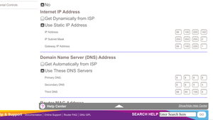

I have an Orbi system behind a Uverse Motorola NVG589. I have read the directions and turned my Uverse modem into bridge mode as much as allowed. (see here) I am not 100% I have done it correctly, so I have taken screen shots of my Uverse and Orbi setup. The problem is, I am having difficutlies with getting my Slingbox 500 (192.168.1.182) to work outside of my home network. This was working with my previous setup. I previously had a Nightgear Nighthawk as an AccessPoint and the Uverse router being the router. Any help would be appreciated.
