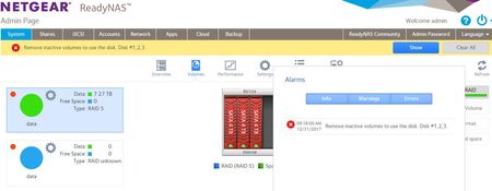

5 TopicsRemove inactive volumes to use the disk. Disk #1,2,3.
My first attemt looks to have failed. Sorry if this is a repeat. My network started to have files access issues and after rebooting everything but the NAS i had nothing left but now I have lost my X-RAID volume and its shares. I have now rebooted and power cycled a number of time and still no luck. I does look like I have a drive going bad (disk2) but it does look to be operational still so that does not explain my issue. Looks like other before me have had the same problem but they do not seem to have a viable resotution for me. Running 6.9.1 X-RAID with 3x 4TB drives Any thoughts?Solved1.8KViews0likes4CommentsNo volumes exits, remove inactive volumes to use the disk. Disk #2,3,4.
