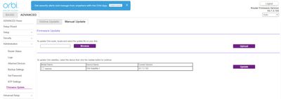

  4. Manual Update Attempt for RBR50... This device doesn't show on the 'manual update' screen and therefore I cannot update (see attached pic).

  • Is this a "special" Orbi sold by Verizon? I notice the tail end of the Verizon logo in your screenshot.
    I have read that the firmware updates of Verizon's Orbi's need to come from Verizon.  The files at Netgear Download sites won't install on those units.
    BTW, this is how my Orbi's web interface looks.  The Router does not show up in the list. Thats normal.
