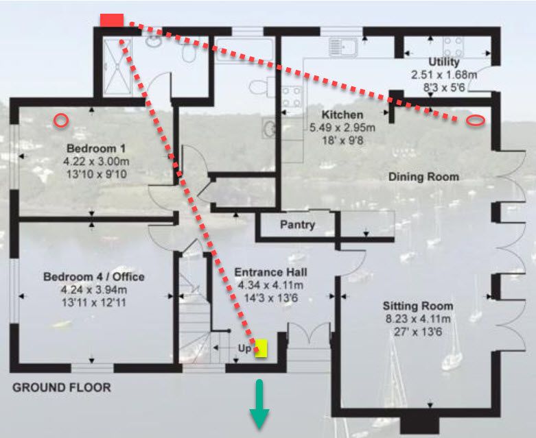

I bought an Orbi RBR50 at end of November '18. The intention was to use the satellite to connect to an outside office I was building and also to an invertor I was installing once the building work was completed. I bought it then to test the distance and it seemed fine. The building work is just completed, I have tried to set it up but have issues. However, because it is 90+ days since purchase it seems I need to throw a question out into the wilderness rather than having a Netgear representative to speak with. Even more gawling is the fact that I may need to buy another satellite to resolve the problem, with no real clue if that would even work. Is there nobody I can speak with first hand? Do I need to rely on the good will of other Orbi sufferers to tap in to their experience and expertise?
Anyway, my problem is this. I have an RBR50 connected (red circle) which doesn't seem to be able to reach a connection to a Solaredge inverter (approx 25-30 feet away - red square). I have a satellite which I cannot ascertain if the invertor can connect to it or not as it keeps trying to connect to the main router. Is there any way I can push the invertor to the RBS50? (yellow square)
Problem two. The green arrow points to the office (approx 20 feet from satellite). Outside my office I have full wifi on my phone. Inside it, the connection totally drops. If this is the case with my phone, is it any more likely that a second satellite will connect to the first?

      What is the size of your home? Sq Ft? >> Has a footprint of about 1200 square feet

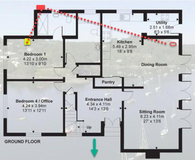

      What is the distance between the router and satellite(s)? 30 feet is recommended in between them to begin with depending upon building materials when wirelessly connected.>> one satellite installed - about 25 - 30 feet apart. There is a cavity wall in between master and satellite router. From master router to the invertor there is an external wall. The invertor is in an IP rated metal enclosure. Stood next to the metal cabinet, on my iphone I have '2 bars' on my wifi, but keep dropping in and out.  I have now moved the satellite to the room on the other side of the wall to the invertor and now have good connection from the invertor (the Solaredge portal software is now updating - it wasn't previously (though I did see their device in my attached devices list)).
      However, this new set-up now moves the satellite away from the outside buildings. I would have expected a better reach than what I am receiving. I would have expected the master router to reach my invertor and the satellite to be installed in the outside office and give good coverage. The way things are looking I may need a second satellite in place where I previously had the first one AND a third satellite in the home office (can I even run 3 satellites?)

      What is interesting is that 9 times out of 10 the invertor will connect just fine to the master router. If I check statrus on the mobile app it shows full strength connection (is there a way to check the connection status via web app?)
