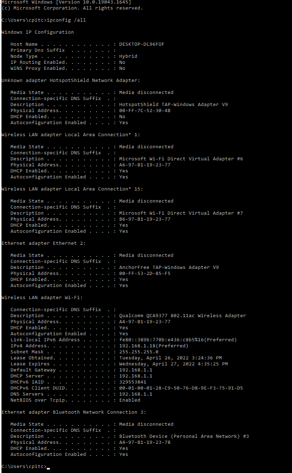

It would be useful to determine the IP address of the computer and the MAC address of the network adapter and then scan the list of Attached Devices for something that matches. (There are many ways to learn this information [internet search]. I usually open a command prompt and type ipconfig /all.

Thanks for providing the ipconfig output. It clearly shows the computer connected via WiFi.
This report is saying that the Ethernet port does not detect a cable connection. It is also a rather unusual description of an Ethernet adapter (anchorfree tap-windows adapter v9), which is related to a VPN service (specifically a 'tap' VPN). My HP computer, for example, describes the Ethernet port as:
Ethernet adapter Ethernet:
Connection-specific DNS Suffix . : peakview.rr.com
Description . . . . . . . . . . . : Realtek PCIe GBE Family Controller
Physical Address. . . . . . . . . : 20-25-64-0F-BA-CD
DHCP Enabled. . . . . . . . . . . : Yes
Autoconfiguration Enabled . . . . : YesDoes this desktop have VPN software?
Sorry not to be more help (so far)
