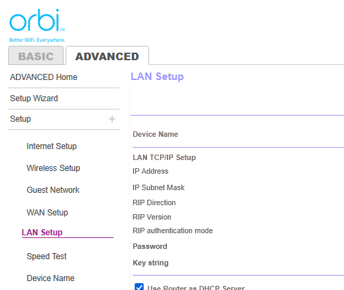

    Device IP assignments are made on this page:

    That screen does mac access control, not IP address reservation.
    Did you mean to say Advanced->Setup->LAN Setup?

      Thank you guys for your replies.  StephenB, sorry, you are right, I mean Advanced > Setup > LAN Setup.

       In my Orbi router,  I goto the Advanced (Tab) > Setup > LAN Setup, and I checked "Use Router as DHCP Server" and I entered a "Starting IP Address" and I entered an "Ending IP Address".  In addition, I have included all (40) of my Address Reservations within the "Starting" and "Ending" IP Address range.  I presume, though, the "Starting" and "Ending" address range is to be used for Non-Reserved IP Addresses??  I did not Reserve IP Addresses for my two Orbi Satellites and the DHCP selected IP addresses for these devices were indeed selected inside the range that I had setup.  In my thinking, the "Starting" and "Ending" address range should be set for RESERVED addresses since the "number of entries" for this type of address is a known count so that I can set the range intelligently,  while the count of addresses for Non-Reserved addresses is not necessarily known.  Are my thoughts correct?

      So the "pool" is defined by "Use Router as DHCP Server" with a Starting and Ending IP Address range?   And the "undefined" range is not used at all, correct?

        FYI, Been a long standing standard networking practice for a long time, IP address RESERVATIONSs should be with in the DHCP IP ADDRESS POOL, i.e. 192.168.1.100 to 192.168.1.200 can be a pool range. STATIC IP addresses are set ON devices and are set outside of the DHCP IP ADDRESS POOL range. Either side of the afore mentioned example range is out side of the pool and can be used by STATIC IP addressed devices. IP address reservations are handled and managed by the DHCP service inside the pool, not outside of it. How it's designed. IP addresses are first Dynamically handed out to devices making a connection. If an IP address is already taken by another, then the next 1st available address it given out. Even if the IP address is already RESERVED in the DHCP pool range, then the next availble IP address is given out by the DHCP serivce, regardless if it's Dynamic or Reserved. How the DHCP system works and intended how to work for most home class router systems.
        https://kb.netgear.com/24089/How-do-I-specify-the-pool-of-IP-addresses-assigned-by-my-Nighthawk-router
        https://kb.netgear.com/25722/How-do-I-reserve-an-IP-address-on-my-NETGEAR-router
      Yes.  Though "undefined" just means that CrimpOn​ has chosen not to reserve those addresses.  Note the last address in the subnet (.255) is a broadcast address, so should not be used for any client.

    Use router as DHCP server means that when any device on the network broadcasts a DHCP request, the router will answer it.  If the feature is off, then the router ignores DHCP requests.  (Some users deliberately set up another device to manage IP addresses on the network and disable their WiFi router DHCP to prevent conflicts.)
    When the router receives a DHCP request, it goes through a process to determine how to respond.  My analysis is that it does this:
    • Looks in the router ARP table to see if a device with that MAC address is already on the network.  If so, the router says "Use this IP address I found in my ARP table."
      (this is the part that we humans find annoying and wish the router would not do this.)
    • If not, the router looks in the LAN Setup table for that MAC address.  If an entry is found, it responds, "Use this IP address I found in my LAN Setup table"
    • If the MAC address is not in the LAN Setup table, the router looks for an open entry in the DHCP "pool" and says, "Use this IP address that appears to be available from the pool."
      (I do not know if the router starts by looking from the bottom of the table or if it starts from the last IP address that was handed out.  Would be something to experiment with (if I cared).
