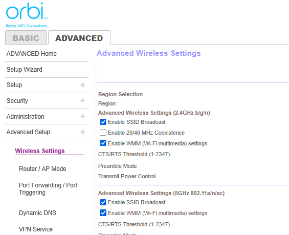

The original Orbi WiFi router (RBR50) has an option on the web interface to disable broadcasting the SSID on 5G.
It is on the Advanced Tab, Advanced Setup, Wireless Settings:
On the phone,
- "Forget" the Orbi WiFi
- Turn WiFi off and back on
- Search for your Orbi WiFi
- Enter password and Connect
Only the 2.4G WiFi will be visible and the phone should connect at 2.4G
After the camera is set up again, enable SSID broadcast on 5G again.
- P95357GuideThank you. I found this procedure and tried it before posting. I unchecked the “enable SSID broadcast” in 5G, hit apply, logged out and restarted the router. With the phone procedure done, I put the Wi-Fi password again and it shows up listed under 5G in the Orbi app. Regardless, I tried the installation procedure in the Arlo app and the camera doesn’t read the QR code that is shown in the Arlo app so the procedure cannot be completed successfully. The app then leads me to troubleshooting steps and the very first item is to ensure the phone is in a 2.4GHz band.

The app then leads me to troubleshooting steps and the very first item is to ensure the phone is in a 2.4GHz band.Your phone might still be using the 5Ghz band from your previous setup. After you hide the 5Ghz SSID in Orbi, go into your phone and Forget the SSID connection (to make sure it forgets the 5Ghz band). Then add it again (this time it can only see and use the 2.4Ghz band). Now try setting up your Arlo camera again.
