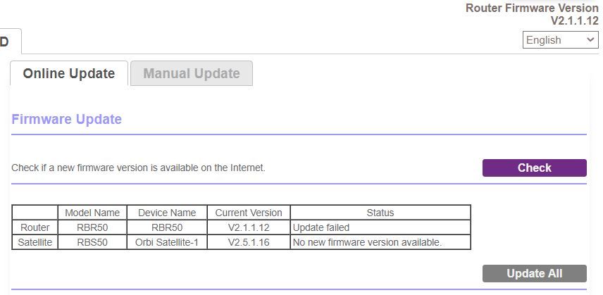

I have one of those RBR/RBS 50 setup which was stuck on firmware version 1.4 something.
I followed the advice from this forum as follows:
Manual update of Satellite and then Router in this order.
  • 2.0.0.74 (Satellite)
  • 2.0.0.74 (Router)
  • 2.2.1.212 (Satellite)
  • 2.2.1.212 (Router)
  • 2.5.1.16 (Satellite)
  • 2.5.1.16 (Router)

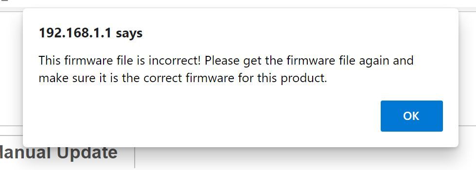

Except that my router would not recognize version 2.5.1.16. The satellite did but not the router. :smileysad:
See below screen dump of my setup. At least, it is still working.
What should I do to move forward with the updates?
(The router indicated "update failed" for all updates but it seems to have worked)
:smileyfrustrated:
  • Hopefully TFTP method will force something on the RBR> :smileytongue:

      FURRYe38 wrote:
      Try 2.3.0.32 on the RBR after v212
      That one did not go through either...  :manfrustrated:
