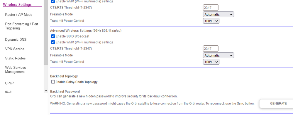

        If that doesn't work, how about changing the Backhaul password:
        Just to put the last "nail in the coffin", do this while the Satellite is powered off.
