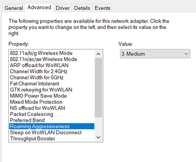

.....2) How can I force the computer to connect to a specific Satellite? In this case it would be the Speaker.According to the implemented standards, it's the computer who chooses which node to connect to, not the router. Please try with the driver setting in yourcomputer, check the following settings (see screenshot below from my computer, when it's approved by a moderator):
- Preferred Band
- Roaming Agressiveness
- Channels widths for 2.4 and 5 GHz respectively.
- Throughput Booster
- Transmit Power

- ekhalilMasterSorry, didn’t see that it’s a MacBook! In MacOS under networks (see the good link the was shared by CrimpOn) you can find some of these settings, but there are much less controllable parameters than what’s in Windows.
