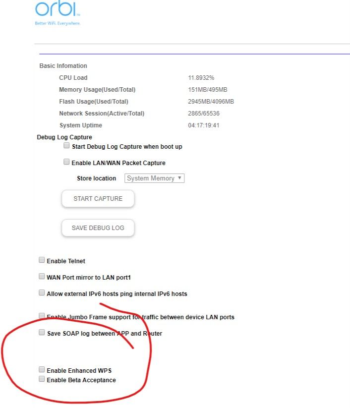

      The synch button is for BOTH setting up additional satellites as well as initiating WPS.
      Orbi supports WPS and something called Enhanced WPS (which is apparently disabled by default)
      https://kb.netgear.com/31239/Does-Orbi-support-Wi-Fi-Protected-Setup-WPS
      See also Page 29 of RBK50 manual:
      http://www.downloads.netgear.com/files/GDC/RBK50/Orbi_UM_EN.pdf
      Edit:  See debug screen on router and/or satellites... has anyone played with the E-WPS setting?
