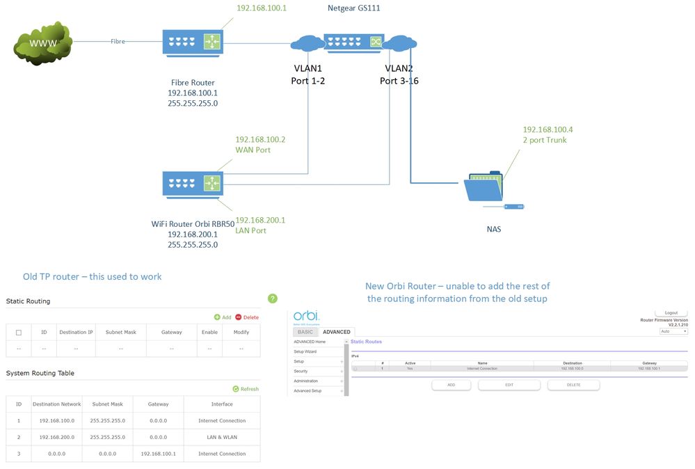

Hi Guys,
This is my first time here and I hope I can get some input from you all.
I have a Fibre connection all the way into the house. The router delivered from the ISP is notoriously poor on LAN/WiFi side, but is providing a stable WAN connection. To cover the WiFi side I have just purchased a trio of Orbi RBK53.
So I've got the fixed modem from the ISP - and I want my new Orbi's to handle the DHCP etc for the network
  • I have created a network with the ISP modem 192.168.100.1/24
  • I have a Netgear GS116 Switch with 2 VLANs
    • VLAN1: Port1 Where the ISP modem is connecting to on its LAN side
    • VLAN1: Port2 Here the Orbi's WAN port is connected and have the WAN IP 192.168.100.2
    • VLAN2: Port3 Orbi LAN side connected to Switch to expand wired capacity
    • VLAN2: Port4-16 LAN "managed" from the Orbi DHCP
  • The Orbi has the IP 192.168.200.1 and is running the DHCP for the "internal" network including WiFi
  • This setup works for almost everything - WiFi and cabled network users have fast and reliable network, the Guest network works perfectly - the only thing that sofar isn't working is my QNAP NAS and the DDNS i relies on for updates, which influences the software updates of the NAS. I had a very similar setup working with a somewhat unstable TP router, where the WiFi simply was insufficient for the building, and now with my lovely new Orbi I can't get the last bit to work...
I would really appreciate some input on where my problem might be.
Best regards
holarsen

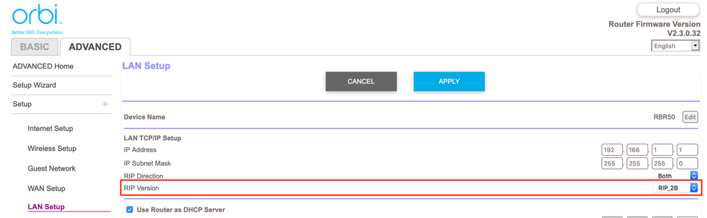

    You probably don't need to add static routes, it's may be enough to just activate RIP in the LAN setup as follows (please try RIP_2B, if RIP_1 does not work):
