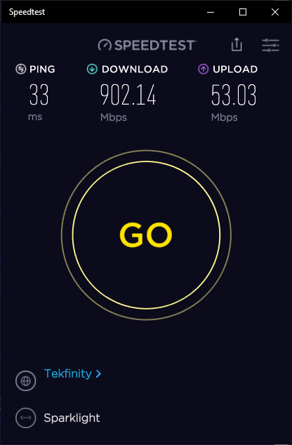

I would try a factory reset on the RBR as suggested. Setup from scratch. Be sure to not enable QoS, Traffic Meter, Access Controls, Armor or Circle on the RBR after completing the setup wizard. Be sure to use Ooklas installable speed test app to speed test with. Web page broswers can give inaccurate speed results.
Just took a speed test with my RBR50 loaded with v2.5.1.16:

50 series Orbi supports near 900Mbps speeds WAN to LAN.
