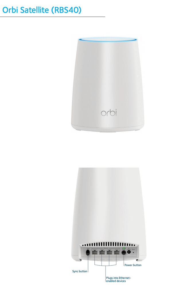

Thanks for the advice! With that setup I'd put the RBR40 (which I already have) in the basement and the RBS40 (which I'd be buying) on the main floor, correct? No issue connecting the RBR40 to the RBS40 via an ethernet cable? I ask because I looked at the back of the RBS40 and I don't see a designated spot to receive traffic... I only see that on the RBS50.

........No issue connecting the RBR40 to the RBS40 via an ethernet cable? I ask because I looked at the back of the RBS40 and I don't see a designated spot to receive traffic... I only see that on the RBS50.
RBS40 has 4 LAN ports (please see picture below from the product's data sheet). You will need to connect one of those LAN ports to one of the LAN ports on the RBR40 to have a wired Backhaul.
