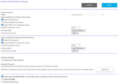

      In case anybody is interested in recommending a different settings combo, here is what I currently have set:
      Weird. I can't get the photo to post. Oh well, here is the text:
      2.4GHz
      Enable 20/40 MHz Coexistence - OFF
      Enable WMM (Wi-Fi multimedia) settings - ON
      CTS/RTS Threshold (1-2347) – 2341
      Preamble Mode – Long
      Transmit Power – 100%
      5GHz
      CTS/RTS Threshold (1-2347) – 2345
      Enable Daisy-Chain Topology – Off (only 1 satellite)
      Enable Implicit BEAMFORMING - Boosts WiFi speed, reliability, & range for all mobile devices – ON
      Enable MU-MIMO - OFF
      Enable Fast Roaming - OFF
