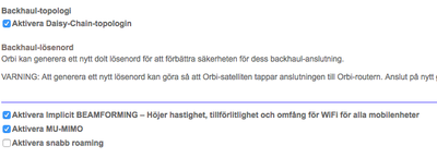

Did a manual update on my router and sat. (update did not show on admin panel or app here in Sweden)
I hade some problem to get the sat to sync with the router after the update.
And when i finnaly got i to work the sat connection showed "bad" and i hade good before and the sat is on the same spot as before and it connented on 2,4.
I left everything over night and looked back in the morning and now the connection was back on "good" over 5G again.
After the update/sync problems it has been working like a sharm for me and it is stable and all devices show up in the list on both the router and sat.
