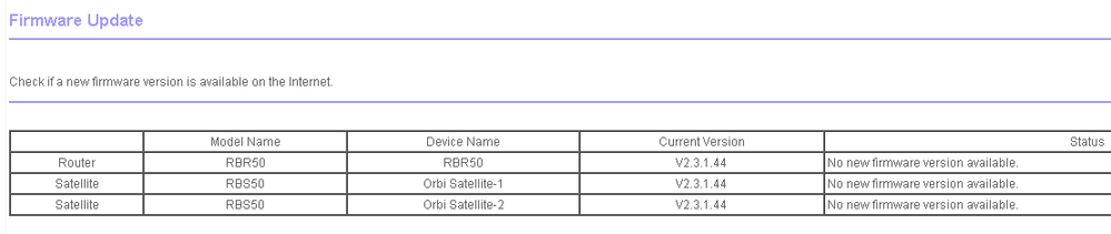

Model Name Device Name Current Version Status Router RBR50 RBR50 V2.3.1.44 No new firmware version available. Satellite RBS50 RBS51 V2.3.1.44 Waiting for connection Satellite RBS50 RBS52 V2.3.1.44 Waiting for connection - BobDelpGuide
Model Name Device Name Current Version Status Router RBR50 RBR50 V2.3.1.44 No new firmware version available. Satellite RBS50 Orbi Satellite-1 V2.3.1.44 No new firmware version available. Satellite RBS50Y OutDoor V2.3.0.28 Update failed - BobDelpGuide
Have you tried a factory reset and setup from scratch on the all Orbi devices to see if the Config Sync issue remains?
Try with and with out Daisy Chain enabled.

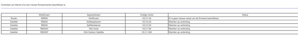

Hmm, I (in The Netherlands) only got the 2.3.1.44 update for the router, no update for the satellites?
And I still got the message that the satellites are waiting for connection (Dutch = "wachten op verbinding")

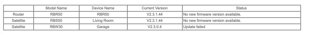

- grservidioAspirant
Here is what I see after the upgrated:
