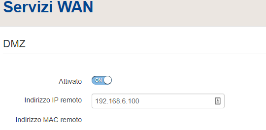

      I followed your instructions
      - wifi disabled on moden
      - set DMZ on router (ip 192.168.6.100 for ORBI)

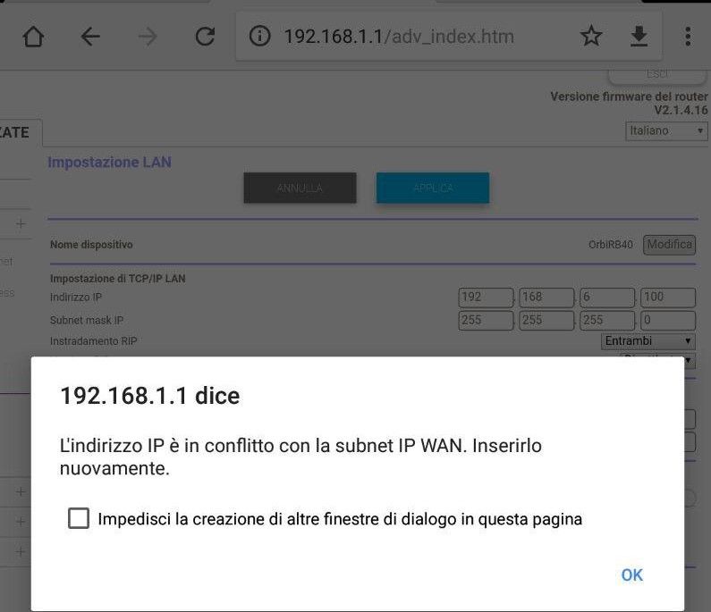

      Orbi set in router mode .. the new ip was 192.168.1.1 and when i tried to change to 192.168.6.100 i got this error
       suggestion?
