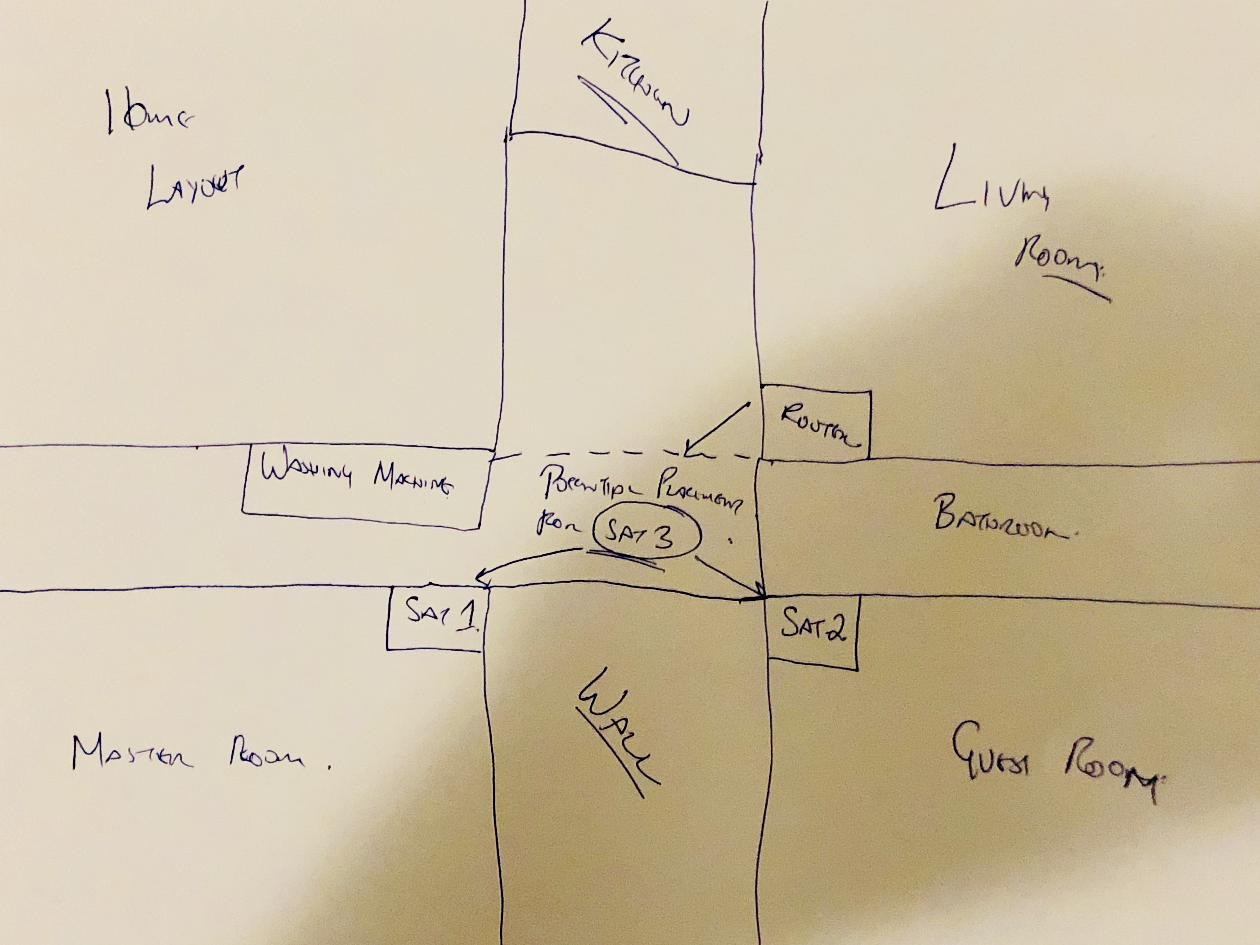

My settings are all DEFAULT in the main Orbi settings page. Key facts:
1. I have daisy chain enabled though my setup is more like a star sort of setup ish. The router is not in the middle per se but its sort of - see attached apartment plan. You can see where the ROUTER And SATELLITE 1 and 2 are placed.
Please help me if there are any advanced settings that I need to tweak to get the Wifi up to speed! ORBI support is absoutely useless giving only 3 months knowing how troublesome their product is. I really want to flog this off and go for the EERO PRO as I'm sure I won't have any issues there. Who cares if I get 20-50mbps less. At least I'm getting Wifi. here I have 300mbps and I'm not even getting 50mbps on Wifi!!!!

It's good that you have fast Internet service, but that has nothing whatsoever to do with what WiFi speed you can achieve.
You've posted in other threads that, "I have tried VELOP, GOOGLE WIFI, and ORBI." If you have tried all these systems and all perform poorly, then it should be clear by now that your problem is not your Orbi. Assuming you are testing with capable WiFi clients, the problem is most likely your RF environment.
Your WiFi speed could be limited due to neighbors' APs, or other RF interference. You may also have more satellites than you need, or have them too close together.
How big is your apartment?
Have you run a WiFi scanner to see if there are other APs visible? Are they overlapping your Orbi?
Do you have other wireless devices--Hue bulbs, Bluetooth devices, wireless speakers, wireless video links, etc?
Are your WiFi client devices capable of 400-500 Mbps throughput? An iPhone 7+ is. I'm not sure about other models.
Do you have a modem from your ISP? Is the WiFi disabled on that? Is your ISP modem also a router? If so, have you set your ISP's box into bridged mode, or have you set Orbi into Access Point mode?
Start with some basic investigation. Enable MU-MIMO and Implicit beamforming on Orbi.
1. Turn off both your satellites and test in proximity to the router first. You will only get maximum speed in the same room as the router, and within ~10 feet of the router.
2. Do not test your WiFi speed using an Internet speed test. You should test your WiFi speeds using iperf3 between two devices on your LAN. Run iperf as a server on a desktop or laptopn wired to your Orbi router. The command is "iperf3 -s". Do your testing with your MBP on WiFi. The command would be "iperf3 -c <IP_OF_SERVER> -t 30" Do not have any WiFi scanning apps open on the MBP. Do not have the WiFi menu open on the MBP during testing.
3. Pay attention to the link speed of your MBP. Option-click the WiFi icon on your MBP. Look at the Tx Rate. You need to connect at 5 GHz and a Tx Rate of 866 Mbps to get maximum speed. You will only ever get about 50% to 60% of the link speed as throughput. If you have an older MBP you might see a slower link speed. My older MBP shows 300 Mbps Tx Rate.

Thanks for your reply. Let's go step by step:
1. I run all the latest devices on the planet. Latest Macbook Pro (fully suped up), iPhone X etc.
2. In my living room where the main Orbi router is, there is my home theatre setup but not bluetooth. Only wifi connected to the Router itself and right now nothing but my phone and laptop are connected to the router. So it's clean.
3. While I've said that my wifi speeds were slow, i meant in the bedrooms, when I tried Google Wifi, the main router was super fast when setup - it gave me some 300mbps up and 200 mps down on wifi. Why I returned it was that in the bedrooms the wifi signal dropped by 50%. With Orbi the wifi connection to the satellite is strong in all the bedrooms - its the main router throughput which is dismal on Wi-Fi, leading to some firmware issue as it was never this way. Also all my cables are all CAT 7 cables and everything is top notch. As stated the speed test within the router is perfect and when I connect my Macbook pro directly to the internet via ethernet the speed again is perfect. So something is definitely WRONG with the Orbi unit.
