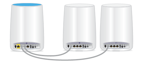

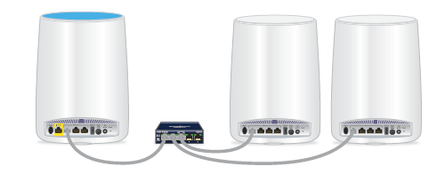

Orbi Ethernet Backhaul causing broadcast storm
I have just upgraded my Orbi router and satellites to V2.1.1.12 hoping to take advantage of the recent Ethernet backhaul feature.  I use the Orbi router as my main router with a 24 port switch servicing the rest of my home network.  When I tried connecting the satellites to the switch via ethernet as demonstrated in the NetGear support article (image below) the satellites appear to have caused a broadcast storm disrupting all communications across the network.
NetGear does not provide any configuration setting other than ensure firmware is upgraded on the router and satellites (they're all running 2.1.1.12).  What am I missing?
I've tried this with and without disabling the Daisy-Chain Topology option with the same effect.

      I spent a day this weekend trying every possible configuration, I factory reset the router and satellites several times, attempted connecting the satellites directly to the router via ethernet and in every scenario the satellites worked at first but upon any changes to the router reconfiguration that seemingly required a reboot (DHCP Reservation, Custom DNS Server, etc) the packet storm would ensue.

      As theorized, wireless and wired backhaul create a loop and flood the network with broadcast traffic. It's interesting that stp is disabled by default on the orbi router when this is the exact scenario where stp is needed. packetwerks is right when they say that this is something Netgear needs to fix. Any adjustments made on a switch (managed or not) are simply stop gaps. Hopefully the people who can fix it actually pay attention to the forums.

  • I too had this problem with V2.1.4.16 and ethernet backhaul.  I am running in AP mode behind a R7800 router.
    The ethernet backhaul network must be dedicated to your ORBI devices.  If you have a switch between your main unit and satellites, no non-ORBI devices can be connected to that switch.  When ORBI devices see packets on the backhaul network segment that they didn't originate, those packets are forwarded to their other non-backhaul network interfaces.  If your switch is connected to both the backhaul and non-backhaul networks, you've created a switching loop and the network grinds to a halt.
    In my house, I have a long ethernet cable run from where the ORBI router is to where the Satellite is located.  That cable is connected to ethernet switches on both ends where I connect other wired devices.  When I connected my ORBIs to each switch with a single cable, I created two backhaul networks: one provided by the ORBIs and the other provided by the switches.
    To fix, I just connected the ORBIs between the switches instead of "outside" them like so:
    Router -> Switch -> master ORBI WAN port -> master ORBI LAN port -> Long dedicated ethernet run -> Satellite LAN port -> another Satellite LAN port -> Switch -> other ethernet devices
    The important thing is that each ORBI unit has two ethernet cables connected.  One for the backhaul network and the other for non-backhaul traffic.
    My bandwidth tests with iperf3 show no performance hit between my two switches with the ORBIs in the middle.  Wireshark confirmed a happy network.
    I think the Netgear wiring diagram cited by the OP did not expect anything else to be connected to the switch between the main ORBI unit and the satellites.
    I hope this helps...

      Broadcast storms can be also seen if the DHCP service on the Orbi mis-takenly hands off 1 IP address to 2 different devcies. Seen this before as well. Users are encouraged to set up IP address reservations ON the main host router for each device, includeing satellites so that each devcies gets it's own IP address when turned on and should avoid IP address conflicts.
      Direct connection of satellites to base Orbi is recommended however switches can be used between and or after the satellite. I use switches in between the main router and satellite for my system.
       https://kb.netgear.com/000051205/What-is-Ethernet-backhaul-and-how-do-I-set-it-up-on-my-Orbi-WiFi-System
      Be sure your using a non managed switch as well.
