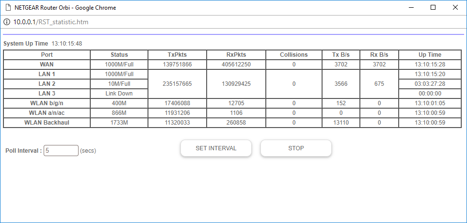

Day 13 on v2.1.1.16 and stable - no reboots. Around Xmas my Orbi was automatically upgraded to 2.1.1.6. And It was reboot hell. Dropped back to 2.0.0.74 still had reboots. Went forward to 2.1.1.6 and hardwired my backhaul to the Sat. Also had issues - then did a factory reset of all custom settings and entered in a select few I needed. Day 13 of no reboots. Can't see any devices connected to my sat but I think thats a UI issue according to forums. Typically 40 devices on Network.
