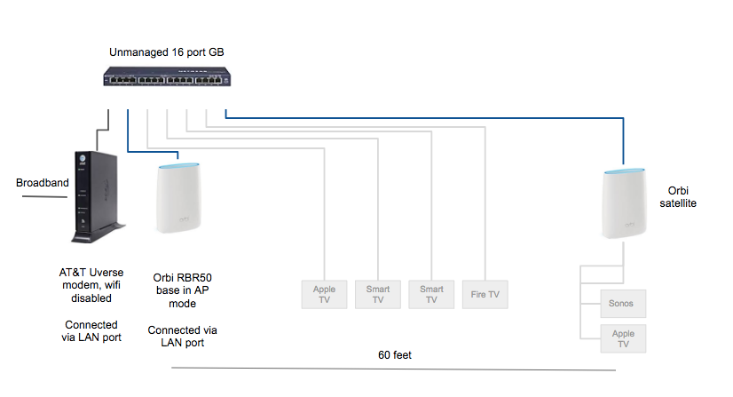

Very large house footprint and really, really want to get by with only base station and satellite.  Living room (most used wifi - imainge a bunch of teenagers on their phones ignoring the world) and ATT Uverse router on opposite sides of the house.  Good news is new construction so Cat 6 just about everywhere - followed advice from posts here and on ATT website.  Setup below:
The setup is working, if I pull power on the satellite you lose wifi connectivity in the living room.  Three main issues:
1) Can't see the satellite in the Orbi app or the admin panel via wireless Mac
2) I can't access the Orbi admin panel via browser when connected to the satellite
3) Performance is mediocre anywhere except near the RBR50
Any ideas?  I'm struggling with the idea that I'll get better performance with the satellite connected wirelessly given the distances. Help appreciated!
(Note that the ATT router is connected to the 16 port switch via LAN came, broadband is connected properly

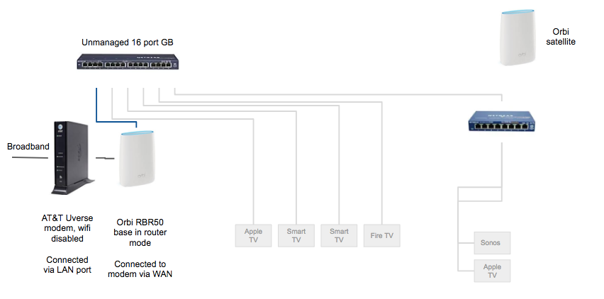

    • jamesdecker24's avatar
      jamesdecker24
      Fixed (sort of) - thanks FURRYe38
      Option 1 apparently isn't an option, per AT&T
      Option 3 is how I thought I had it set up, but I actually had it in the WAN port.  Discovered that too late. :P
      So I decided to go with #2, (followed directions here) but before hardwiring the satellite I decided to just hook it up completely wireless to at least baseline the performance.  It's working very well in the main areas (big improvement over my old setup).  New network looks like this:
      I'm going to let this run for a bit to benchmark it (see if the teens complain) and then maybe take a shot at replacing the 8 port switch with the satellite and hardwiring it.  I can try one other location to test the wired backhaul performance (curious if anyone has benchmarked improvements).  Then maybe try it as a fully wired satellite to replace the 8 port switch.
      The 16 port is a Netgear GS116 unmanaged.  Trying to keep all the networking gear same manufacturer.
      • FURRYe38's avatar
        Guru
        Ok, sounds good. Just making sure your switch isn't managed. Orbi doesn't like Managed switches for some reason. Hope the new configuration works better.
