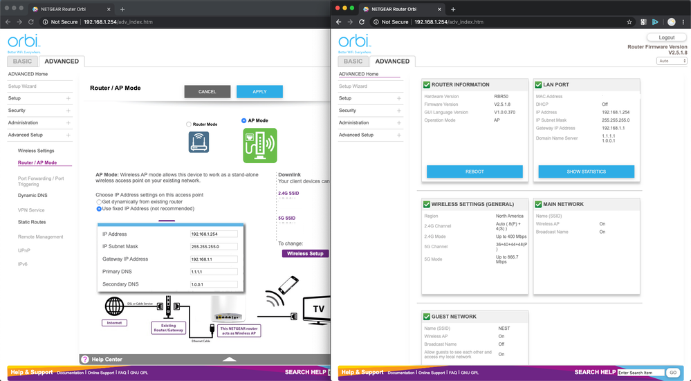

  • I have xfinity and ran into a similar problem.  After assigning the Orbi a reserved/static IP LAN address, I didn't have to reboot due to IP renewal problem anymore.  With a static IP, Orbi will disable its internal DHCP automatically and therefore avoid the need to renew IP address via DHCP.  This has worked very well for me.
    If you have xFi router from Comcast, you can put Orbi in AP mode and give it static IP/GW/DNS address.  At least you don't have to worry about WAN DHCP IP address renewal with ISP modem/router and DHCP/WAN IP address renewal is no longer an Orbi's problem.  Here is an example of my curent Orbi AP configs:
