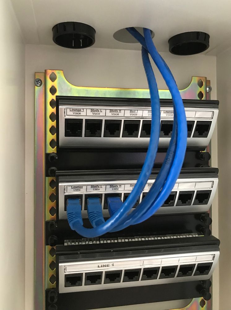

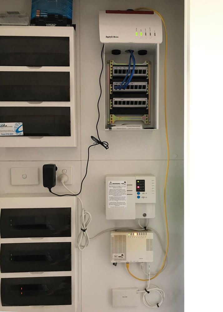

      I have attached a couple of photos to show you where my modem is located, which is in a cupboard, next to my kitchen. I don't think I can move my modem to a better location as there are three RJ-45 cables connected to the modem which connect to my study room and lounge room via a network of wall sockets.
      In the lounge room I have a Netgear Hub which has RJ-45 cables connected to my TV, Apple TV and PVR

        with your setup and each room being wired, you could centrally locate an access point.
        You could use a router, an extender with access point mode, or even an access point.
        having everything hardwired gives you lots of options.
