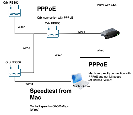

Orbi RBK53 Speed Issue with wired backhaul
Last time I found issue with unstable wireless backhaul. Now I using wirebackhaul. I found the problem. Orbi didn't support gigabit in WAN port or something.
I use brigde mode from ISP and use PPPoE connection from Orbi. Max internet speed is ~500-600Mbps upload and download for LAN connection and ~400-500Mbps with Wireless connection (tested by Speedtest Mac App and nPref in website - MBP 16" 2019)
I try to connect PPPoE from my mac. Max internet speed is ~900 Mbps (upload / download) with LAN connection
Do you have any idea to fix it? I try with 2.5.1.16, 2.7.2.104 and 2.7.3.22 firmware too
and I have only one computer. I never test LAN gigabit of orbi ... with iPerf
Something to see if that works. Also might see if keeping PPPoE on ISP router, configure RBR for router mode and put the IP address the RBR get from the ISP router in to the ISP routers DMZ and speed test then...
