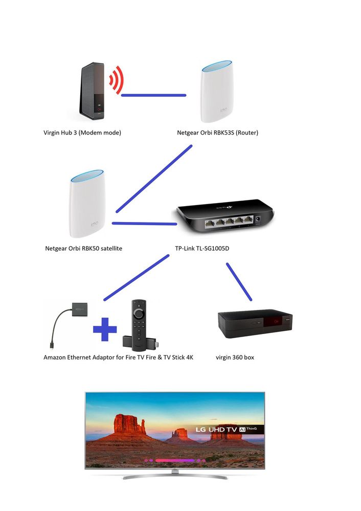

Hi, I recently purchased the Orbi RBK53s to improve our Wifi and the results have been fantastic, but it's blocking my iptv app on my firestick - all was working fine before the Orbi was installed.
I've uploaded a photo to try and explain my layout,
The modem ( i've switched to modem mode only) is conected to the Orbi router from this theres a ethernet cable to my PC (not shown) and then a cat6 cable that goes into the Orbi satelitte . There is a second Orbi satellite, not shown connected via wifi on a split landing.
The connected satellite is then connected to the TP Link which the Fire stick and a Virgin box also connect to, the firestick then connects to the TV via a usb port, the TV box connects via a HMDI cable.
I subscribe to a IPTV service and this is accessed through a app that I downloaded on to the Firestick.
Since installing the Orbi, I have been unable to login into it, although the Amazon Prime I also subscribe to has been fine and completely unaffected.
I can however log into the IPTV app if I use a vpn service but speeds are reduced from to approximately 10mbps which is useless and this also then blocks my Amazon Prime and other subscriptions.
Any help or advice will be greatly appreciated

    Does the firestick work if connected to the RBR and not the RBS?

        Is the ipTV app the only app that fails on the Fire Stick?
        Does this Orbi have Armor or Parental Controls enabled?

    (This does not address the problem, but.....) I believe the Fire Stick connects to one of the TV HDMI ports. The USB connection goes to the Fire Stick power supply
    Connecting the Fire Stick to one of the router LAN ports would be a good troubleshooting step, except that the Fire Stick must be plugged into the TV.  I actually bought a 100' ethernet cable from Amazon (about $20) to do wacky things like this (when I'm alone in the house).
    The Fire Stick also connects over WiFi. Does changing to WiFi make any difference?
