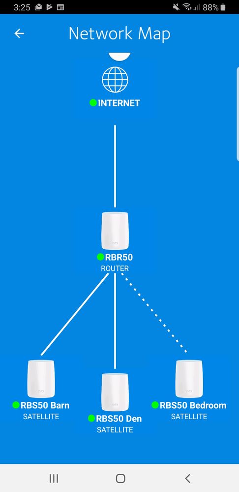

Cheers- Chuck_MMentor
Short answer, Absolutely.
I have three satellites (RBS50s) in my house and they work superbly.
Another thing to think about is the associated backhaul -- e.g. how they connect back to the main router.
The optimal solution is to hard wire them if possible to maximize speeds. Of my three, I have two hardwired and the third uses RF to communicate back to the router.
See Orbi Network diagram below
