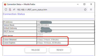

    What does it show on the Advanced Tab home page when you click the Blue Box Connection Status?
    I'm interested in the DHCP lease that was provided by the ISP.  Spectrum assigns me a one day lease (actually 86,400 seconds).
    What DHCP lease does your ISP provide.  Does the next "service break" happen when the lease is due to expire?

    • Bugwald's avatar
      Bugwald
      The lease time is 20 minutes, and the remaining time (at this point) is 12 minutes. It doesn't match with the drop interval.
