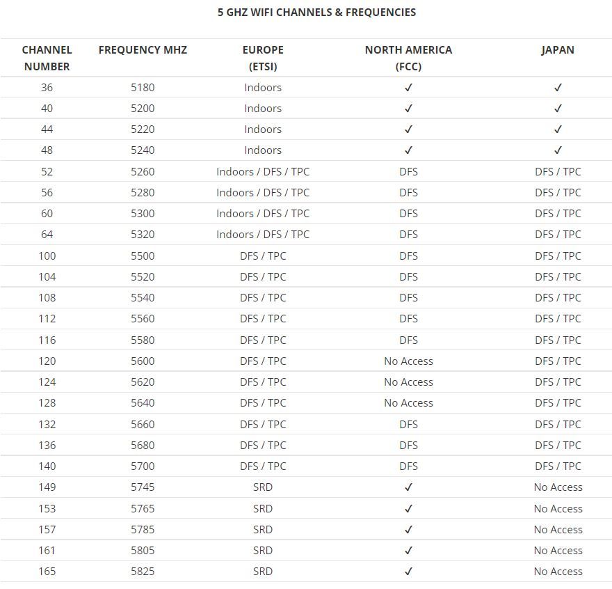

So I think that if I could deactivate the use of 5GHz channels that are in the range of radar (DFS) I could solve this problem:
Anybody knows how to avoid the use of these channels in the router?

  • In Orbi, the DFS channels are only used in the wireless backhaul, that is the wireless interface between the router and the satellites.
    To change channels when radar interference is detected is the correct thing to do and according to design. This change should be seemless and you should not see any impact. How do you notice the "wifi drops"? Do you see this on devices connected to both the router and satellites?
