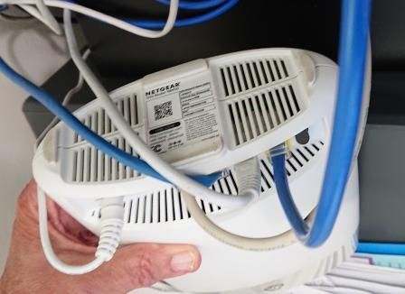

      • CrimpOn's avatar
        CrimpOn
        Orbi's come with two labels.  One is plastic wrapped around the case.  The "real" label is on the bottom of the case.  Hard to imagine anyone removing it.  Here's a picture:
