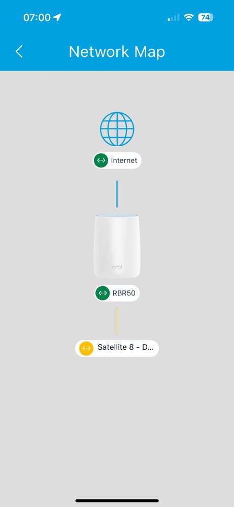

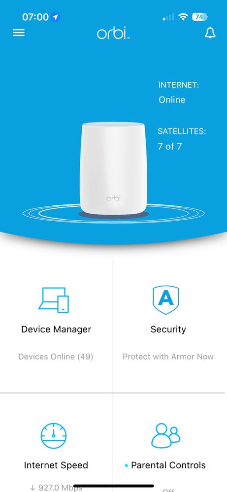

the orbi app shows that I have 7 satellites connected, (3 wired), which is correct, but the map only shows one of them.

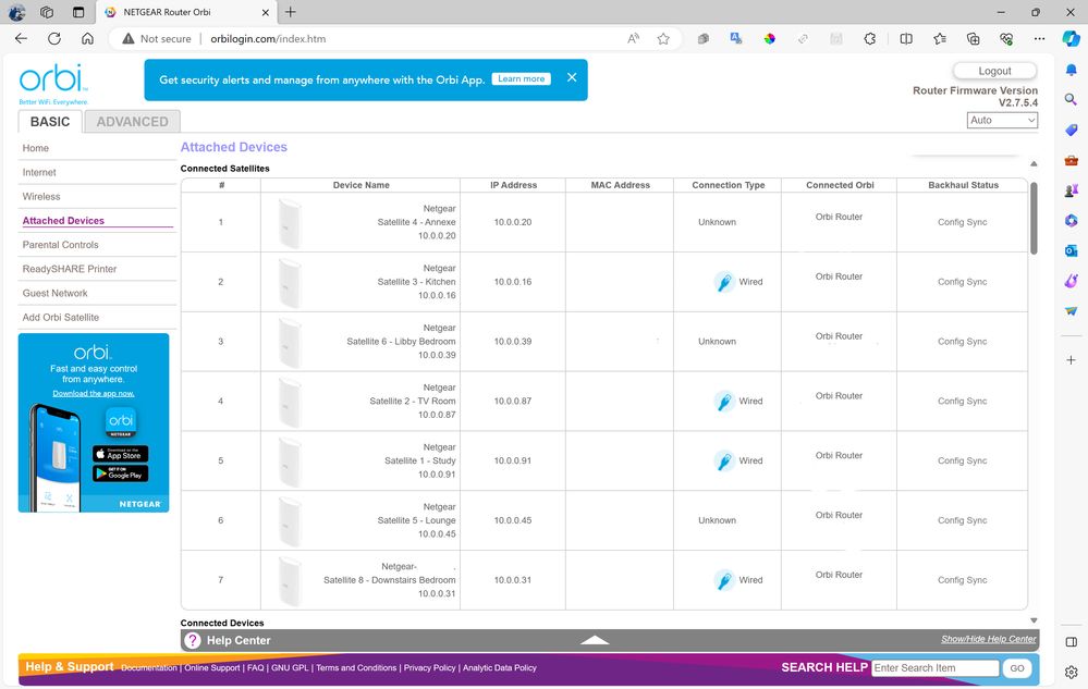

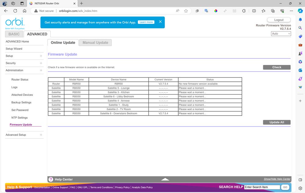

the orbilogin page shows my connected devices, but doesn't show their firmware version (though i know all are v2.7.5.4) or their backhaul status.

Screenshots attached to help show the issue..
  • My guess is that information about the satellites is not appearing because they are in the "config sync" state.  i.e. the router to satellite connection is not fully established.
    My suggestion is to power them all off.  One at a time, relocate each satellite to the same room as the router, do a Factory Reset (on the satellite), connect it to the router, and wait for it to sync.  Then, relocate it back to the desired location.

        The "Unknown connection" shown is also a factor, probably related. All satellites are wired?
