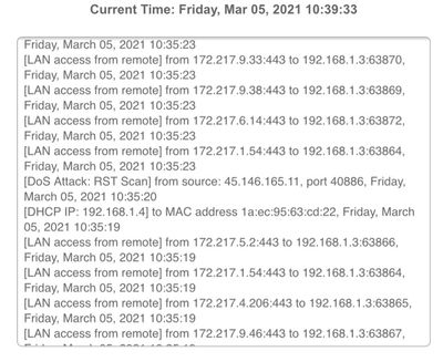

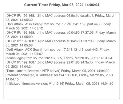

What could be attracting the DoS Attacks?  The ports they are scanning are at the end of the list and high port numbers.  (Ill add a screen shot). And what is the best method of stopping them?
The photo is off the Orbi after it is connected to the "new" modem.
Thanks ahead of time for any help you can provide.  I am at a loss on this one.  Figured I would reach out to the real pros working with the Orbi
    There are programs running that constantly scan every public IP address looking for open ports and attempting to connect. They cannot be stopped, just as there is no way to prevent people from calling your phone number (robocalls).  You can choose not to answer, which is what the Orbi does.  The Orbi firewall has routines that attempt to classify connection attempts in various ways. (I have seen comments claiming that Netgear is overly-aggressive at identifying "DoS" attempts.) The two Orbi systems that I get logs from identify at least 80 "DoS Attacks" every day.  I repeat, the Orbi rejects these connection attempts, just as I do not answer most phone calls.  There is no harm in 'hecking the option on the Advanced Tab WAN Setup "Disable Port Scan and DOS Protection."
    Once Remote Management has been activated, the Orbi actually does accept connections (the default port is 8443). When programs find port 8443 is accepting connections, they attempt to log in.  This will fill the Orbi log with "Invalid Login" messages.  With my 25 character Orbi admin password, it will take about 8 billion years for someone to gain access.
    • Ph0t0bug's avatar
      Ph0t0bug
      Tutor
      Thanks for that info.  I have a long secure password as well just didnt want to cause any extra traffic if I could avoid it.  Thats reassuring.  :)
