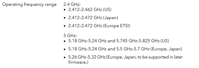

WiFi frequencies depend on Region (where in the world). For the "50-series" Orbi they are:
5.775GHz (5,775Mhz) is the frequency band used for the 5G WiFi backhaul connection between router and satellites.
I would expect the frequency scanner to also detect the user facing radios operating at 5.18-5.24GHz.

None of the typical LTE frequency bands are at the same 5,775Mhz frequency used by the Orbi backhaul (North America).
So, my initial impression is, "no dice." If typical WiFi interfered with LTE connections, nothing would be working - not cell phones, not LTE modems or Hot Spots. Nada.
