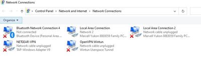

I changed the TAP name to NETGEAR-VPN

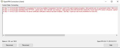

Here is the config that my Orbi generated and OpenVPN does recognize that when I click on it.
Now when I click to connect I just get a yellow box with the status connecting over and over. This is the GUI and the logs, but from what I've read they aren't really that important and shouldn't prevent me from connected. I'm at a loss so please, I'd be so grateful for any insight and direction you could provide me.

    I believe this has to do with the software creating an artificial network adapter which is described as a "TAP Windows Adapter" and has to be renamed to match the configuration file (NETGEAR-VPN).  Somehow, I have messed this up (sigh).
