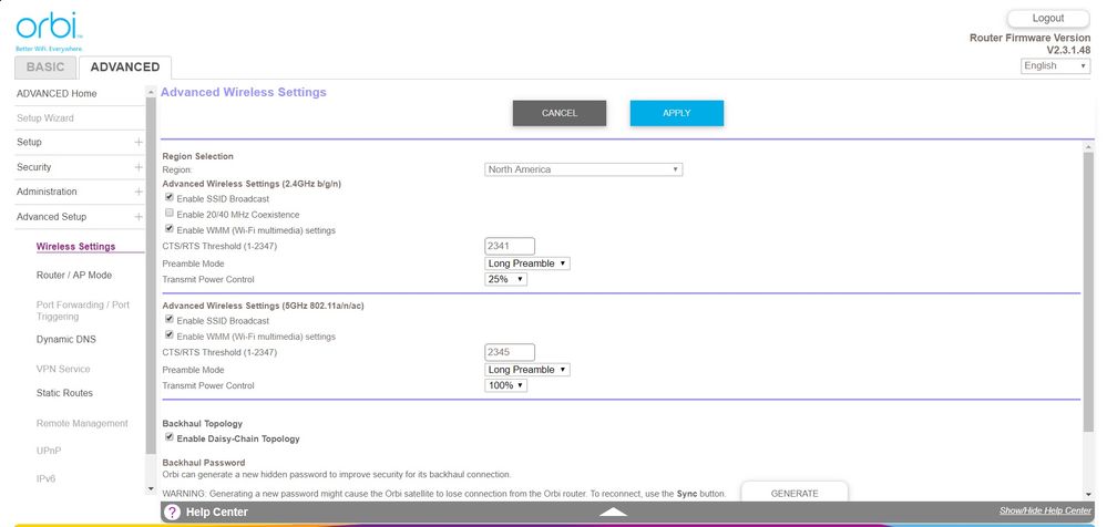

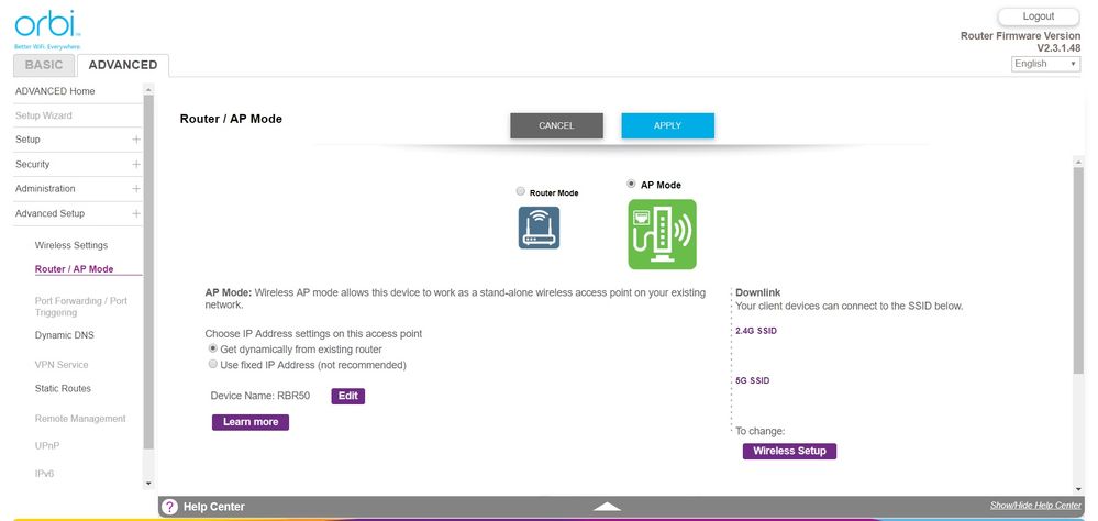

Hello,I have some orbi setting and setup questions.(Sorry my English is poor.)
Beacuse iOS disconnection issue,I referenced to https://bit.ly/2CoOybd
and my brother's Samsung is constantly being dropped!
My Orbi setting:
And my setup is correct?Sometimes will happen connection problem...
referenced to https://bit.ly/2ZkDcyZ and https://bit.ly/2tDV9N7

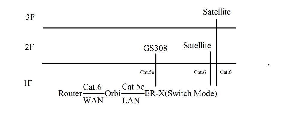

My setup:
Hope everyone can give me advice.
Thanks!

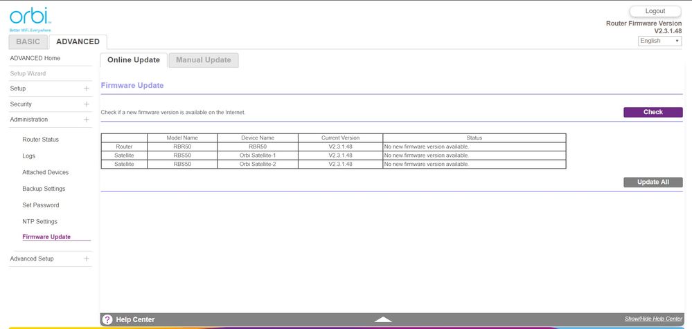

  • What Firmware is currently loaded?
    What is the Mfr and model# of the ISP modem the NG router is connected too?
    What is the size of your home? Sq Ft?
    What is the distance between the router and satellite(s)? 30 feet is recommended in between them to begin with depending upon building materials when wirelessly connected.

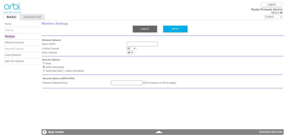

    Try setting manual channel 1, 6 or 11 on 2.4Ghz and any unused channel on 5Ghz.

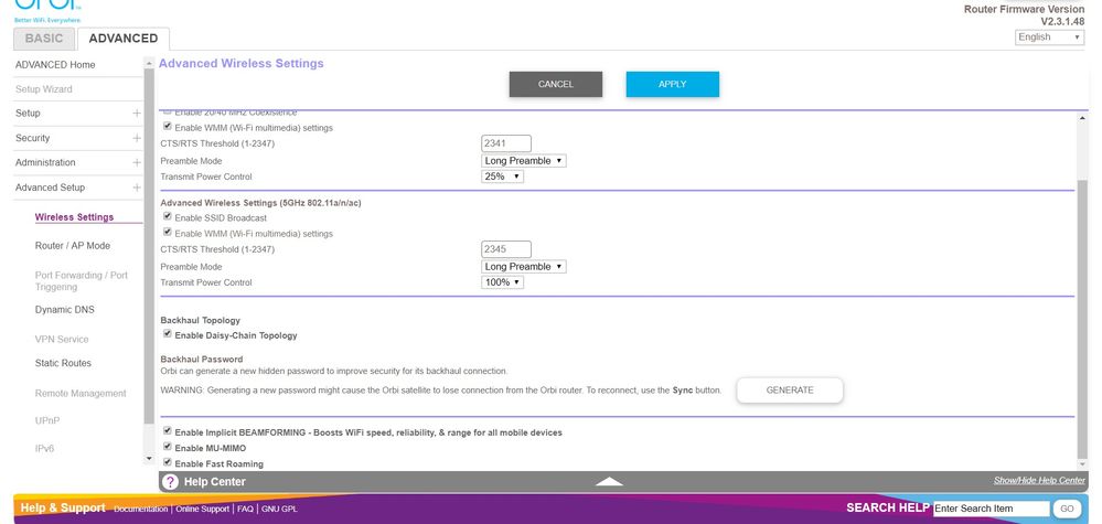

    Try enabling Beamforming and MIMO and WMM. Under Advanced Tab/Advanced Settings/Wireless Settings
    Try disabling the following and see:
    Daisy Chain, Fast Roaming, IPv6 and Set 20/40Mhz Coexistence to 40Mhz only. Save settings and reboot the router and satellite(s).
      V2.3.1.48
      I don't know...But router and satellite(s) distance one floor.
      Any Wifi Neighbors near by? If so, how many?
      2.4Ghz channel is 1,and 5Ghz is 44.
      It' enable.
      OK,So I will disable Daisy Chain, Fast Roaming, IPv6?
      And how to Set 20/40Mhz Coexistence to 40Mhz?I only see "Enable 20/40Mhz Coexistence" chose...
      Thank you!
