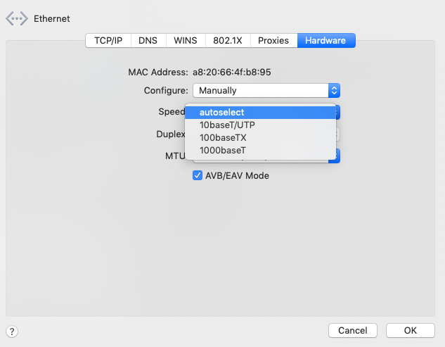

      1) The fact that you'r getting speeds on the limit of the 100BASE-T speed makes me think that this can be a wrong setting in the iMAC, Please check iMAC settings under >> System Preferences >> Network >> Ethernet >> Advanced >> Hardware >> then check what you have there. You shouldn't have 100baseT. Try also to set it to Manually and 1000BaseT / Fulll Duplex and see if this changes anything, as you can see below:
      2) Please also try another LAN port on the Orbi, it can be a bad pin 8 on one of the ports?

        A continuation of this post, please try the following settings in your iMAC:
        System Preferences > Network > Select Ethernet on the left side > Select Advanced > Select Hardware Tab
        Change settings to following:
        Configure: Manually
        Speed: 1000baseT
        Duplex: full-duplex, energy-efficient-ethernet
        MTU: Custom - 3000 and above
        AVB/EAV Mode: Checked
