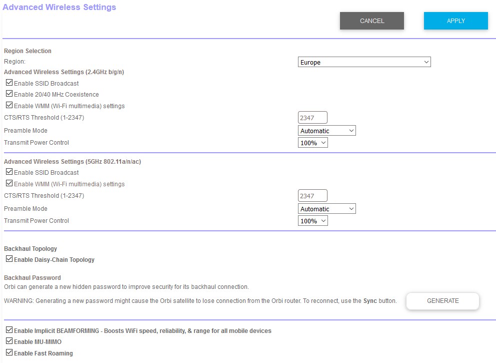

    20 feet is kind of close in between the router and satellite, you could try this, set the power levels on the Orbi router from 100% to 75% and see how it goes.

      Also I found the page in Orbi that has the power settings, but there are a bunch of other settings that I may or may not have already changed. I've attached a screen shot of the current settings.

      [edit]As you recommended I've changed the power settings to 75% for both 2.4GHz and 5GHz.[/edit]
