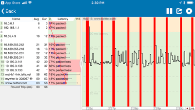

My Orbi satellite and router are running on firmware 2.1.1.16
Today I noticed that my VoIP calls, web browsing and online gaming all hang at the same time. This prompted me to monitor the stability of the network and came up with the following graph:
It seems strange how regular the periods of packet loss are. I have already ruled out my ISP being at fault. This also happens on the latest beta firmware. Anyone having this same issue?

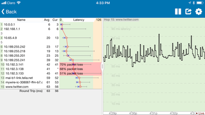

        I did some experimentation and found that INDEED the Orbi router and satellite are interfering with each other. For my testing, I shutdown the sattelite unit completely leaving only the router unit operating. Without changing anything else, I ran my original test and came up with this:
        The packet loss pattern is now gone completely. For futher testing I stressed the WiFi network with VoiP, online gaming and web browsing simultaneously with excellent results. Everything ran smoothly just as it should.
        The problem now is that my WiFi range is severly limited since the satellite unit is off.
