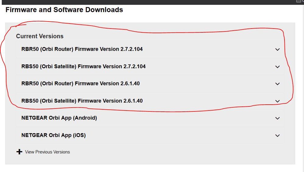

RBK50 - two firmware versions?
Why are there two firmware versions for the RBK50 and which one should be used?
Edit: screenshot doesn't seem to be working but the versions are 2.7.1.104 and 2.6.1.40.
  • Yes, two versions, and no explanation why.  Isn't it a hoot!
    There is an urban legend that the 2.6 firmware might be intended (a) for world wide rather than US, or (b) for customers who prefer to remain with Disney Circle rather than migrate to the new Netgear Patental Controls. At one point, one of the versrions was labelled "U.S. Only", but that comment has disappeared.  Netgear provides NO EXPLANATION.
    So, what are customers supposed to do?
    • One school of thought is, "if it ain't broke, don't fix it."  We see posts every day that start off with, "updated Orbi firmware and now....(something horrible happened)."  All these "security fixes" seem focussed on the LAN side of the Orbi, not on security breaches from the Internet.
    • Another school of thought is, "If a security fix is serious, Netgear will push new firmware."  During the origiinal setup, users have to click "ok" to the statement, "i realize that Netgear may push firmware updates to my system."  Then let Netgear do what they said they'd do.
    • There are some of us who think, "what the heck, it new firmware does something bad, I will just reinstall the firmware I had before." No Biggie.  I am on 2.7.2.104. Had some hiccups and did a factory reset. Now all good.
    You wanted answers. Sorry.

    • shobuddy's avatar
      shobuddy
      CrimpOn, yet you love your Orbi? j/k
      Thanks for the response. I just upgraded to v.104 and am having issues.  Went back to v.102 and having the same issues.  Going to go to v.104 and do a factory reset *fingers crossed*.

  • Two versions of each - one is for the router and the other is for the paired satellite.
    Some firmware versions do not work/are incompatible with certain ISP systems.
    For example:  If you purchased your Orbi system from an ISP, they will have their own choice in which firmware to run on the system and will remote update for you.  This is common in the cable modem systems; the Orbi environment can be created in a similar fashion.
