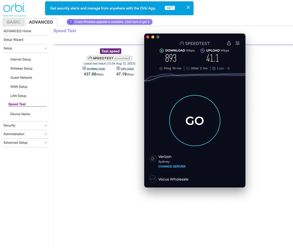

Attached is an image of my Orbi Speedtest taken seconds before the same test on a Mac that is wired into the back of the RBK50.  Should I expect these to be in the same ballpark? They are WAY off. I'm also only getting what the Orbi is reporting on wifi devices around the network, not what the wired device is getting. Would that setting or issue be impacting the wifi performance?
Normal?  Ideas?
Internet Co-axial 1000MB direct to street cable (not to an internal building concentrator or anything)
RBK50 FW 2.7.3.22
RBS50 Wired Backhaul (x2) on different floors.
the Mac that was used to generate the screenshot is wired into he RBK50.
    OzGobo wrote:
    The Orbi is reporting 437 down, the macOS app on the device that is wired into it is reporting 893.  This seems odd.🙂
    Odd is correct.   One would expect that the router itself and a device wired directly to the router would report the same speed.  With a gigabit ISP connection, that is normally in the 800-900Mbps range.  It is a bit irritating that the router Speed Test function does not report which Speed Test server was used to perform the test.  (Notice that the Mac reported using Verizon and offers an option to select a different server.)  In my case, I have noticed that Speed Test reports can vary significantly.
    It might be worth running Speed Test on the Orbi several times to see if the reports are consistent over time.
    WiFi device speed is definitely a function of the WiFi network and specific device capabilities.  The RBK50 ("K" for "Kit", consisting of one RBR50 Router ("R") and one or more RBS50 Satellites ("S") is built on 802.11ac technology with two antennas (2x2 MIMO).  A WiFi device with two antennas can theoretically achieve a Link Rate of 867Mbps when placed very close to an access point.  Internet searches for "what speed can I expect to get?" turn up all sorts of information.
    I do not find it surprising that WiFi devices connected to this 802.11ac system continue  to report Speed Tests in the 400Mbps range even with the higher ISP connection.
    The speedtest on the app measures the throughout between the router and the modem. In other words, while it uses wifi, that is just to control the test. It effectively measures the speed of your internet connection.
    Anything else has to navigate whatever else is on your network.
    Your wifi speeds will never match your wired speeds. They depend on the technology on your wifi clients.
    If your ethernet wired Mac has the same speeds as your wifi clients, then something odd is happening.
      Perhaps I'm not understanding you. That webpage from the Orbi is loaded on the wired Mac, as is the app.  its a screenshot from the same device.  The Orbi is reporting 437 down, the macOS app on the device that is wired into it is reporting 893.  This seems odd.  The only reason I'm concerned is that wireless devices don't seem to get above about 420 anywhere on my network, and I'm wondering if this test result is any in anyway impacting that performance.  I don't expect to get 893 from a wired device on this network, but I'm thinking with 890+ coming in the front door it could potentially be better for the wireless devices?
      As a bit of history, the speed of the internet connection was recently increased from 250MBPS to 1000.  While it was set at 250, the Orbi app consistently reported 256MBSP down, and 24 Up.  Supposedly its now 1000 down and 50 up.  Since that, all Orbi devices have been restarted, as have many of the devices in the network.  Both backhauls are ethernet.
        As I tried to explain, those two measurements are from different places and along different paths.
        Just because they both use Speedtest does not mean that they are measuring the same thing.
        My Windows PC also has a speedtest App. In that case it is not measuring the same thing as the Mobile (Android) app.
        The app measures the speed between the router and the Internet.
        The measurement using the browser graphical user interface (GUI) is done through whatever network hardware connects the Mac to the router. (You sad the Mac us connected to the RBK50, which doesn't exist as a model number – it is a bundle of router and satellites –  so I assume that you mean the RBR50 router.
        You said that the Mac was wired to the router. So it is navigating its way through your Mac's LAN drivers and on through the router out to the Internet.
        This may well be as fast as your wifi clients can go. (Thanks to their wifi chips that is the top speed for many 5 GHz devices.) Your Internet connection could by 10 Gbps, but if your wifi clients have technology that hits the ceiling at ~400 Mbps, that's it.
        Do these wifi client give better speeds when tested somewhere else?
        I would expect to get something near ~890 Mbps on the local wired network. Your wiring and your network hardware must be pretty poor to throw away half the speed.
        Perhaps this is the clue:
        When the speed went up, did you reconfigure the router for the newer Internet connection? As it was with the old service, the router will have set itself for the 250 Mbps connection. If those settings are still in there, that could slow things down.
        The usual advice when changing the Internet service, even with the same ISP, is to reset and reconfigure the router for the new service. The least you should do it so take the router through its Internet setup process.
