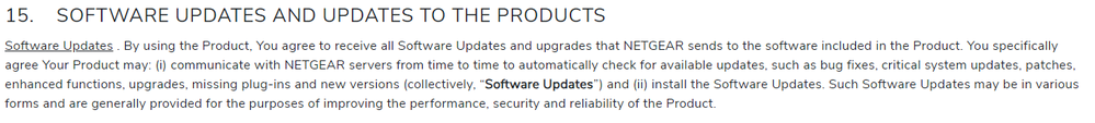

Netgear released firmware v2.7.5.4 in February 2023. To this day, the Firmware Update feature of both the web and app iinterfaces do not detect and offer to install this version. My own (personal) conclusion is that this product has "fallen off the radar" and no one is assigned the task of managing the firmware update process for it any longer.
Firmware updates are a touchy topic on the forum. When customers install the product and agree to the Terms and Conditions, one of the things they agree to is
There were several unpleasant situations when forcing firmware updates wreaked havoc, and Netgear has modified their internal procedures several times. The firmware process typically includes these steps:
- New firmware is released and appears on the support web site. Users are able to detect the new firmware and can choose to install it manually. Many do so and report their observations on the Community Forum.
- If there are not many reports of problems, after some indefinite length of time Netgear "flips a switch" (metaphor) and the Firmware Update process will detect the new firmware and offer to install it. Often this happens in a month or so. In the case of the RBR50, it has been 18 months! (and counting)
- Finally, at some point in time, Netgear may decide that "it's time" and push the firmware in the middle of the night. (This has happened to me.)
With the latest versions of the Orbi AX series, Netgear has introduced an option called Orbi Auto Firmware Update which allows customers to Enable or Disable upgrade to the latest firmware. Customers who prefer to "wait and see" when new firmware comes out can disable this feature and decide for themselves when they want to update. Some systems have this new option. Many (like the RBR50) do not..... and never will.
The thousands of customers who never look at the Orbi app or web interface are blissfully unaware of all of this.
