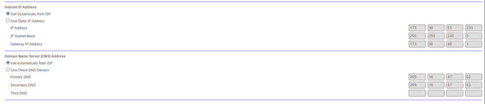

Are you using ISP detected DNS or custom DNS?
Is IPv6 enabled on the RBR?
ANSWER: No

Looks like DNS from ISP (my notes said a long time ago Spectrum wanted that....but perhaps I should adjust ?)
