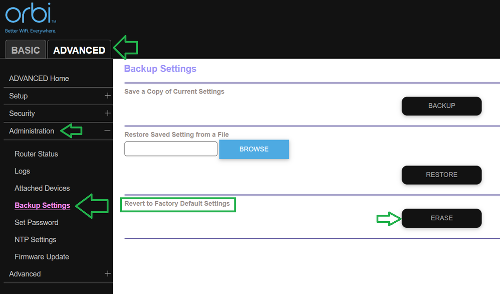

Erase Button on RBRs Web Page: (Recommended)
NOTE: This also sends the factory reset command to any, and all synced and connected RBS satellites.
Otherwise, you can manually factory reset using the reset button behind the RBR and RBS:
Press the back reset button for 15 seconds then release.

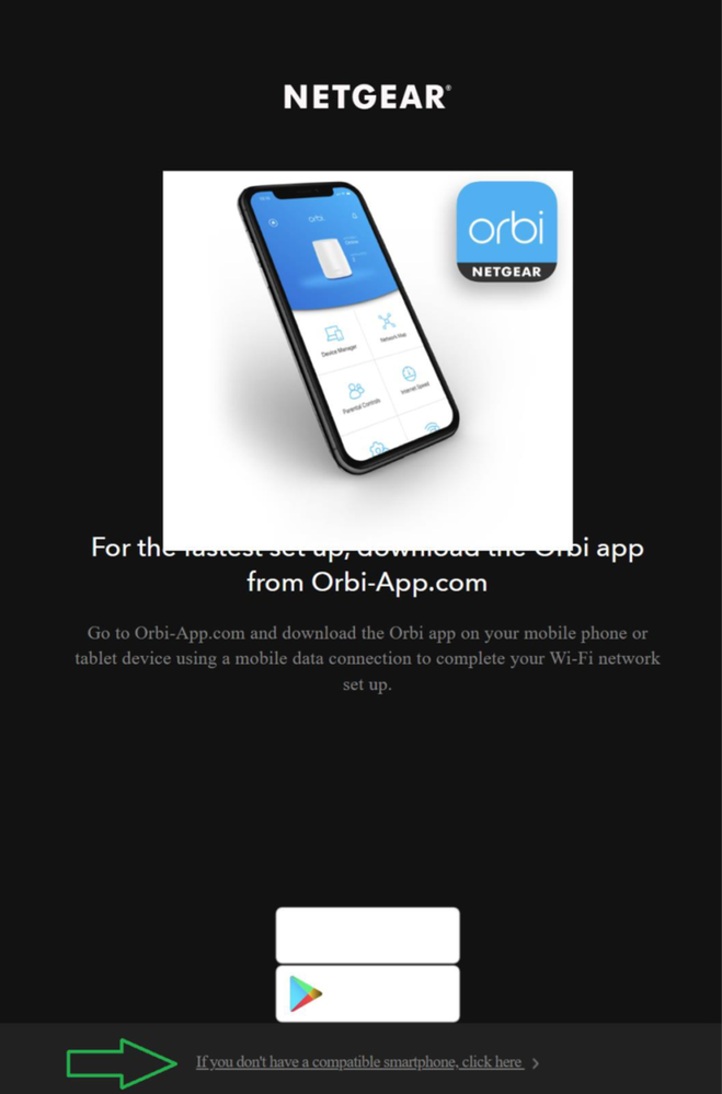

When RBS front LEDs are BLUE, select the "If you don't have a compatible smartphone, click here" at the bottom of the RBRs setup wizard web page.

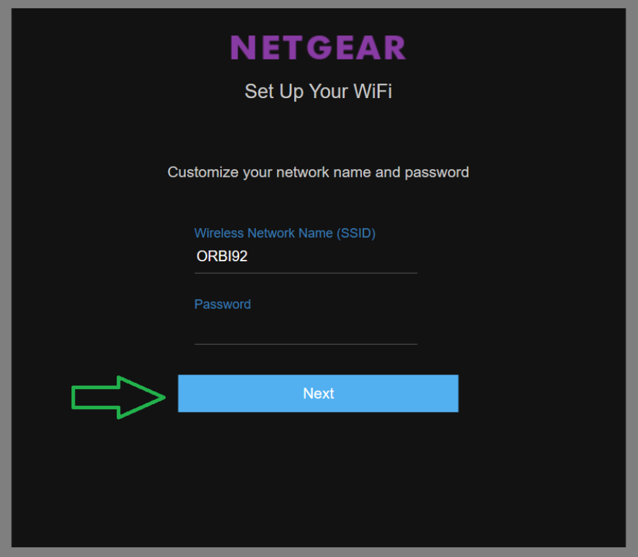

At the Set Up Your WiFi page, leave the SSID name and Password default. Don't change it here. Just select NEXT:

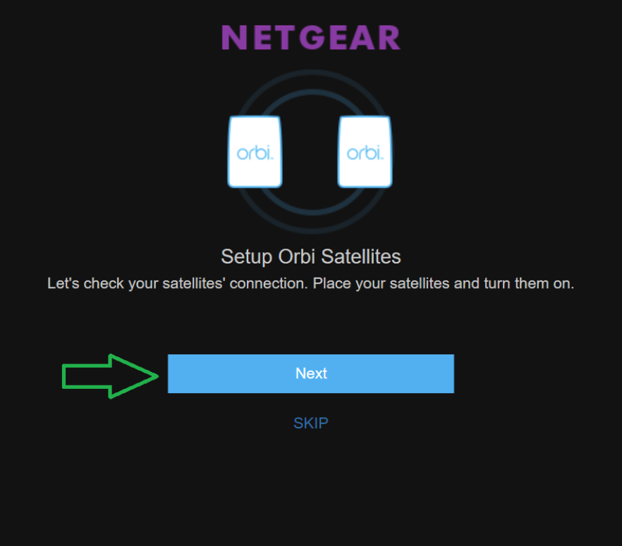

Select NEXT at the Setup Orbi Satellites:

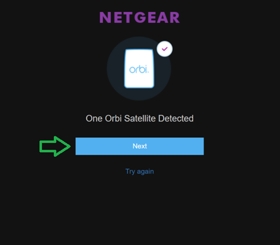

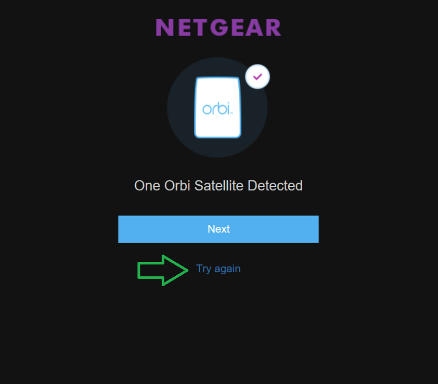

If any, and all RBS were ON and connected and showed BLUE before beginning the setup routine, all RBS should be detected correctly here. Select Try again if needed:
Might wait a couple of minutes if needed. All present RBS should be detected.
Select NEXT after all RBS satellites are shown to be connected.

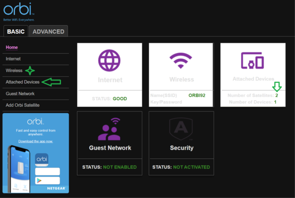

Confirm that you see RBS satellites listed under Attached Devices menu on the RBR web page.
Any, and all RBS should show a GOOD status and connected. Out of Sync should not be seen here. Front LEDs on RBS maybe BLUE for up to 3 minutes then turn OFF:
If “Out of Sync” is seen for the RBS status, give 2-5 minutes extra for the system to update the status on the RBRs web page. All present and connected RBS should eventually show a GOOD status.
